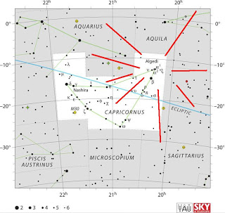

α-Αιγοκερίδες(CAP) - α-Capricornids (CAP)
πηγη imo.net
http://www.imo.net/files/data/calendar/cal2013.pdf
Active: July 3–August 15; Maximum: July 30 (λ= 127); ZHR = 5;
Radiant: α = 307 , δ = −10; Radiant drift: see Table 6;V= 23 km/s; r = 2.5;
TFC: α = 255 to 0 , δ = 0 to +15 ,
choose pairs separated by about 30 N);
IFC: α = 300, δ = +10 (β > 45 N), α = 320, δ = −5
(β 0N),α = 300, δ = −25
(β < 0).to 45
The CAP and SDA radiants were both denitely detected visually in former years, standing
out against those much weaker ones supposed active in Capricornus-Aquarius then. Whether
the CAP can still be detected as visually separate from the ANT radiant area is unclear, as
its radiant now partly overlaps that of the large ANT region. Observers failed to find a clear
maximum for the shower in 2009 for example. However, their bright, at times fireball-class
brilliance, combined with their low apparent velocities, might make them distinctive enough to
be detected still by means other than video. A minor enhancement of CAP ZHRs to ∼ 10 was
noted in 1995 by European IMO observers. Recent results suggest the maximum may continue
into July 31, with similar lunar conditions to the 30th.
