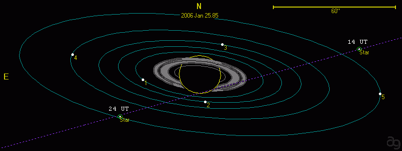

Dear Dave, dear all,
about a week ago I made colorized versions of the winOCCULT graphics for demonstration purposes.
For those of you, who are not familiar with the outputs of Dave Herald's program:
* The first illustration shows the situation as seen from the star. The times given in the small inset table are valid for Mainz, for other places please refer to Dave Herald's list below.
* The second graphic gives an overview of the star's passage through Saturn's inner satellite system as seen from the earth. The satellite positions refer to 2006 Jan. 25.85 = 20:24 UT.
Regards
Alfons Gabel
